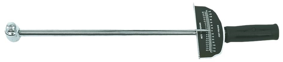

    Динамометрический ключ обычного типа (которому за сто лет) до сих пор делают со стальным нагрузочным элементом. А ведь могли бы из люминия
    Всем известные факты из статьи, на которую дал ссылку schizo
    it is well known that aluminium alloy has a finite fatigue life, so the failure of Richard’s fork steerer is not unusual in that regard. I’m sure there are many cyclists that have observed or discovered cracks in an alloy set of bars, a stem, seatpost, rim or frame. Such fatigue and failure is not unique to alloy though. Any material is subject to the wearing forces associated with cycling, and as such, every cyclist must consider that each part of the bike has a finite service life.
