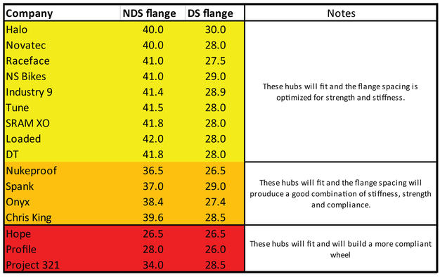

    Цитата Сообщение от bruto Посмотреть сообщение
    на фото фигня - фланцы у ДХ втулок делают, как хотят и единого стандарта нет
    у Хопе, AC узкие и симметричные, у Новатеков широкие
    https://http2.mlstatic.com/masa-nova...9_112017-F.jpg
    http://www.wigglestatic.com/product-...-MTB-Hub-B.jpg
    Докину маркетологизма в тему 157х12
    So why 157?
    AVAILABILITY: 150 / 157 hubs have been around for years. The only difference between the two measurements is an end cap on the hubs and slots in the dropout for the 157 width. These hubs started out having flange widths that were similar to a standard 135 or 142 hub, and while some manufacturers have stayed with that flange width many have widened their flanges in an effort to make a more durable wheel. If we look at the dedicated Super Boost plus hubs they typically have a non-drive-side hub flange distance of 41mm and a drive side distance of 28. We noticed that many manufacturers have progressed with their hub design and even though they don't call them Super Boost plus they have the same flange width. So this means there are already numerous hubs and wheels available from some great companies. Heck, you might even have a set in your garage already!
    "если хочешь хорошего от шимано - то это удочка." (c) mac
